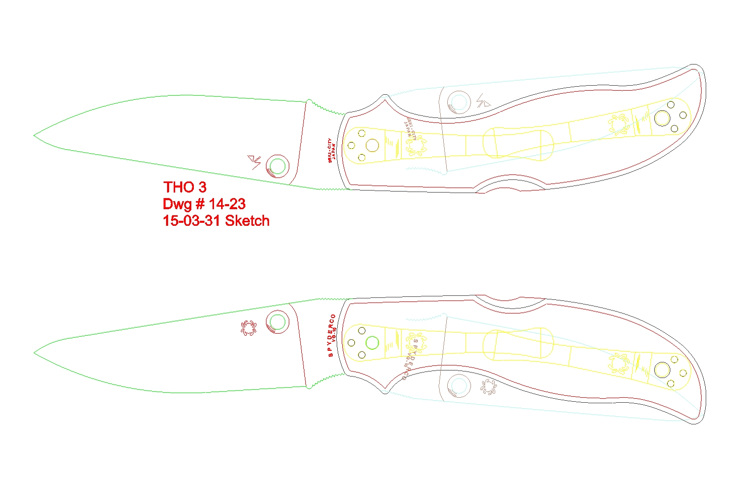

I've enlarged the blade (wider and longer) and raised the tip. I'll try to get a pic to Peter early next week as I'm out again on Thursday.

@All: What we get now is the sketch from THO 3 :)

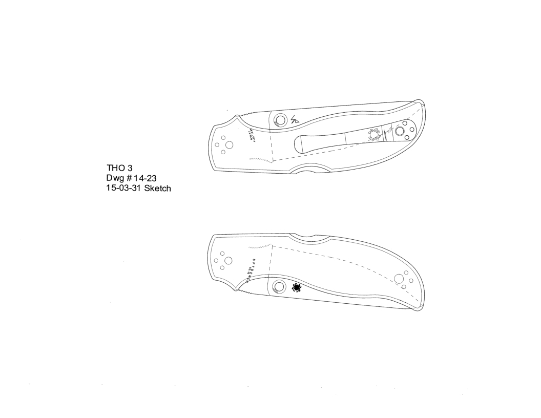

Looks a lot better, I think I could live with that.
However, in closed position, the bladetip seems to almost poke out of the handle. It doesn't, of course, but it's very close. I had knives where that was a problem, because the skin of my hand would go between the handle sometimes and then get cut.
It might just look that way.
Best regards,
Simon

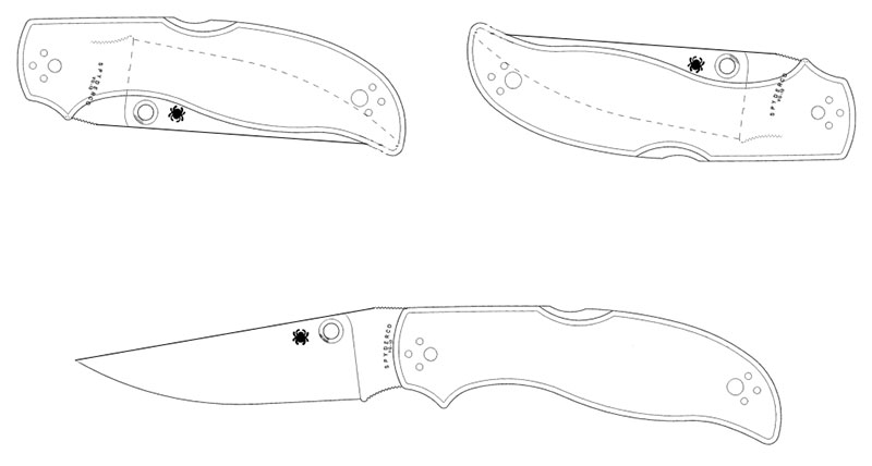

Sal & Peter, thanks for the update.
I am a little bit puzzled about the shape of the spine of the blade.
The curve at the tip looks like one of my knives where the tip broke off and I had to regrind it.

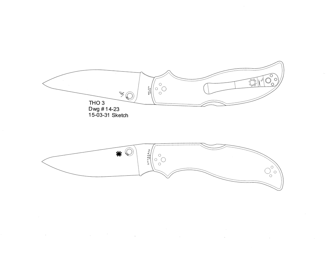

I took the liberty and changed the blade shape a little bit so that it doesn't look like a reground tip anymore:
Hi there,
WOW, MojoMCs slightly changed silhouette of the blade looks great to me.
I would buy it - even as Austrian who doesn't need to care about knife laws :steirer:

If I take the original Spyderco sketch from the closed knife, I wonder if it's still a Two-Hand-Operated knife?
For me it looks like there is plenty of space for thumb and forefinger to grab the blade and flip it open. (Stretch handle has enough weight for this motion)
And as a side note: Deep pocket wire clip is still my preferred choice :rolleyes:

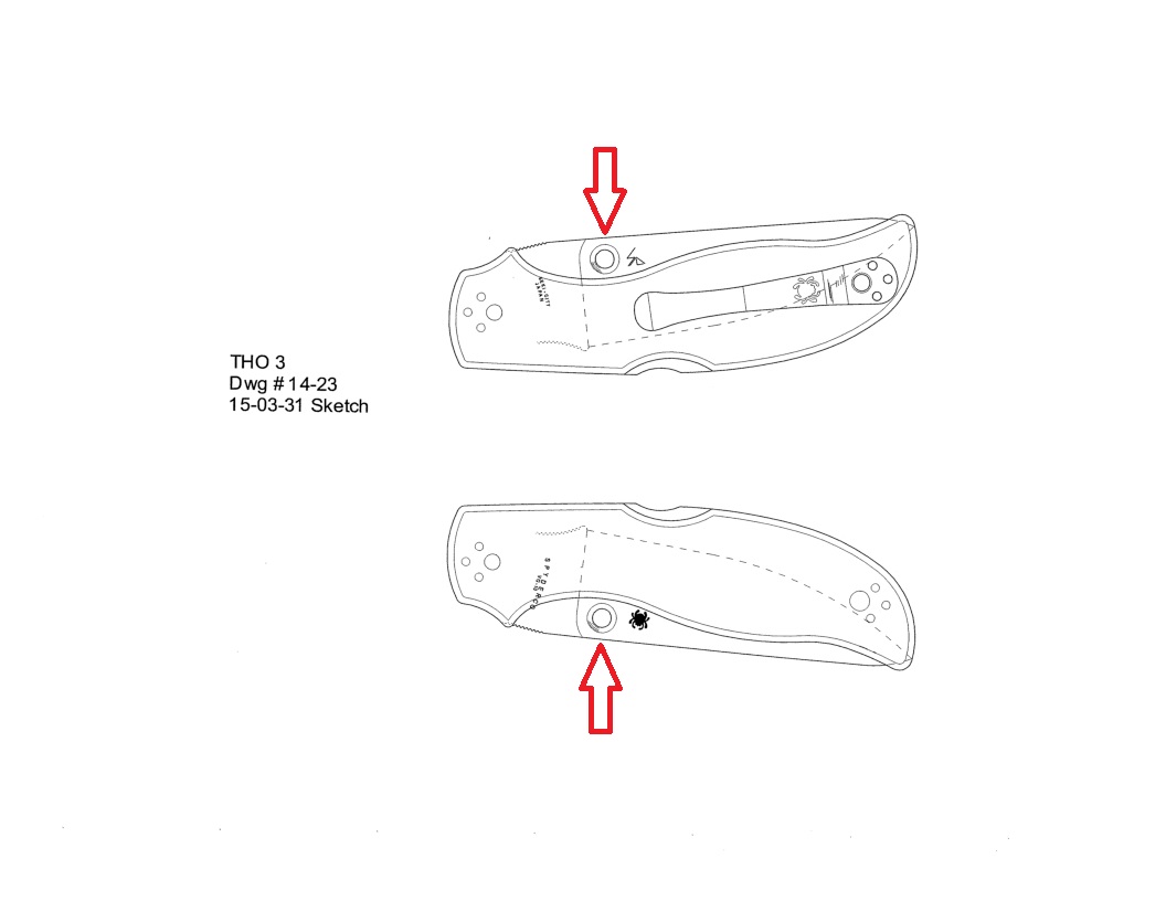

Peter, I agree with You.
Better to have an engraved hole imho, that gives the knife the typical Spyderco-Look, than to have an (even) small hole with the possibility to open it with one hand.
And yes: deep pocket wire Clip.
Andreas
Better to have an engraved hole imho, ...
We are invited to discuss a lot of details with Spyderco, but an engraved hole instead of the trademark (original and empty) hole is beyond all question. Please don't ask for any alternative solution what the hole concerns.

Hi Andreas, As peter mentioned, the trademark is a through hole.
Peter, Is that considered a one hander if you can do a "Spyder drop" (thumb-forefinger hold and drop handle).

What about a Southard without a millet slot for one hand opening? The top of the hole could be used as a nail nick. Another benefit is the fact, that you don't have to change your benchmark and one handed closing would be possible.
To cover the hole and top of the blade both scales would have to be bigger, and the flipper has to go.
What knife is it that has a Feststellungsbescheid and how does one get one? Is that the only German legal THO?
Almost any knife can be grabbed by the blade and snap the handle down to open, I can do that with a Swiss Army Knife. How would one get around that? Also, almost any locking knife can be inertia opened. How do we get around that?
If the entire blade is submerged below the handle, and there is no flipper, how would one access the blade? Even with two hands?
