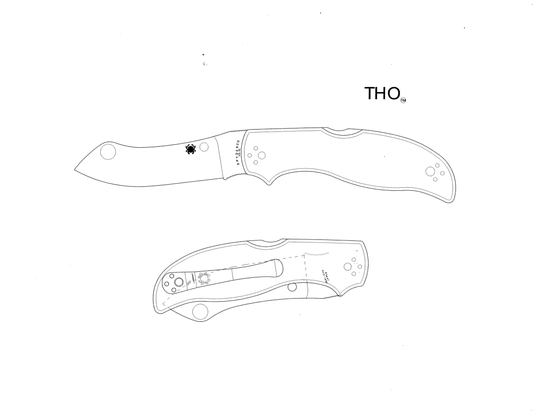

Hier haben wir mal die erste Zeichnung des "THO"; kam gestern von Sal -
Here we have the first drawing of the "THO" I received from Sal yesterday:
Kommentare? Comments?
Anregungen? Suggestions?
Are there some initial considerations, which handles there will be for this knive?
Thanks a lot for the first sketch, Sal.
Very smart idea to move the Spyderhole towards the tip of the blade :super: - it might just not be sufficient in the eyes of our "law enforcement" to classify the knife as a two-hand-operated one.
Hmm - the shape of the blade ... not really what I would like to see, but this is a question of personal taste.
Too much belly on the edge and the spine curve before the Spyderhole looks to deep for me. What about a straighter (even convex) spine line and less belly, which would bring us more in the direction of a sheepfoot or Sebenza Insingo type of blade?
A deep-carry wire clip would also be more interesting for me than having the possibility to choose between a tip-up and tip-down configuration.
Just my five personal cents - curious to see the next steps :D
Regards and all the best for 2015!
Virgil

I'd like to thank Peter for posting the first drawing of a Two Hand Opener (THO) being developed for the German market.
This is an initial drawing and I believe that we'll need discussion to bring it forward. Much of the design has been thought about for many hours and the sharing of thought should bring us closer. I believe that first I will need to explain my thinking for the design.
The first consideration is that we are designing a model to meet a law. This is much different than designing to perform a function. The knife laws as silly as they may appear are still the final word in any given area. The design parameter for this model is that; 1) it must not be able to be opened with one hand and 2) it must lock open.
Knives that can be opened with one hand are; 1) flicked open using inertia (or a spring), 2) opened by using one's thumb to interact with an appendage on the blade such as a thumb stud, disc, or other appendage added to the blade to facilitate one hand opening, 3) using one's thumb to interact with a hole or depression in the blade to facilitate one hand opening.
The "flicking" open of a knife must be dealt with first because most locking knives can be "flicked" open by a skilled user. (many of the authorities doing the testing are skilled at flicking open a knife). This is a major concern and is of primary importance in dealing with government authorities. If a knife can be "flicked" open, it is similar to the dreaded and feared "switchblade" knife, which causes women to scream and grown men to cry. In Australia, it is the major test of a legal knife. Similar in New York City. Why this is so important to governments is primarily ignorance, (the nuns running the whorehouse), but it is something that we as manufacturers and users of knives have to deal with.
Knives can be "flicked" open by holding the handle and rotating the knife quickly in some manner (often with a twist) to deploy the blade. Another method (as used in New York City) is to grab the blade that protrudes from the handle when the knife is closed (usually with the thumb and index finger) and snap the handle down to deploy the blade and have the knife in the "ready" position to do harm.
In order to eliminate the flicking capability, one must remove as much weight from the blade as is possible without decreasing strength which could make the knife flimsy. The next issue was to permit little or no blade sticking out of the handle when closed so it is not possible to grab the blade and snap the handle down. This grabbing needs to be as close to the pivot as possible or the knife when flicked will not be able to be used without a major adjustment to grip.
The model as drawn puts as much of the blade deep into the handle as possible without damaging ergonomics or blade strength. I selected a 3mm blade thickness for function and strength.
While the blade has a hole in the "trademark" position to identify the knife as a Spyderco, it is a small hole (too small to thumb open) and the hole is slightly submerged below the handle scale so a thumb stud cannot be added.
The "hole" in the front of the blade is NOT a hole. It is made of two concave dimples which we call a "Double Dent". It is easily grabbed with the thumb and index finger to easily and safely deploy the blade with the second hand. We are using this opening concept on a new model we have called the "Roadie" which was just released this week. The "Double Dent" will not trap debris and is easily cleaned. It does give the knife an Interesting (strange) appearance, but we are seeking function over looks.
The blade as drawn is 3.5" long from the handle to the point and the handle is basically a "Stretch" handle with a finger choil. We used a lock-back as it has the most effective detent for keeping a knife closed. We added a Boye dent to the lock to prevent accidental unlocking. We can also used a smaller lock well to eliminate the Boye dent.
Please think about it ane we can go from there. It would be foolish to create a design that the market doesn't want.
sal

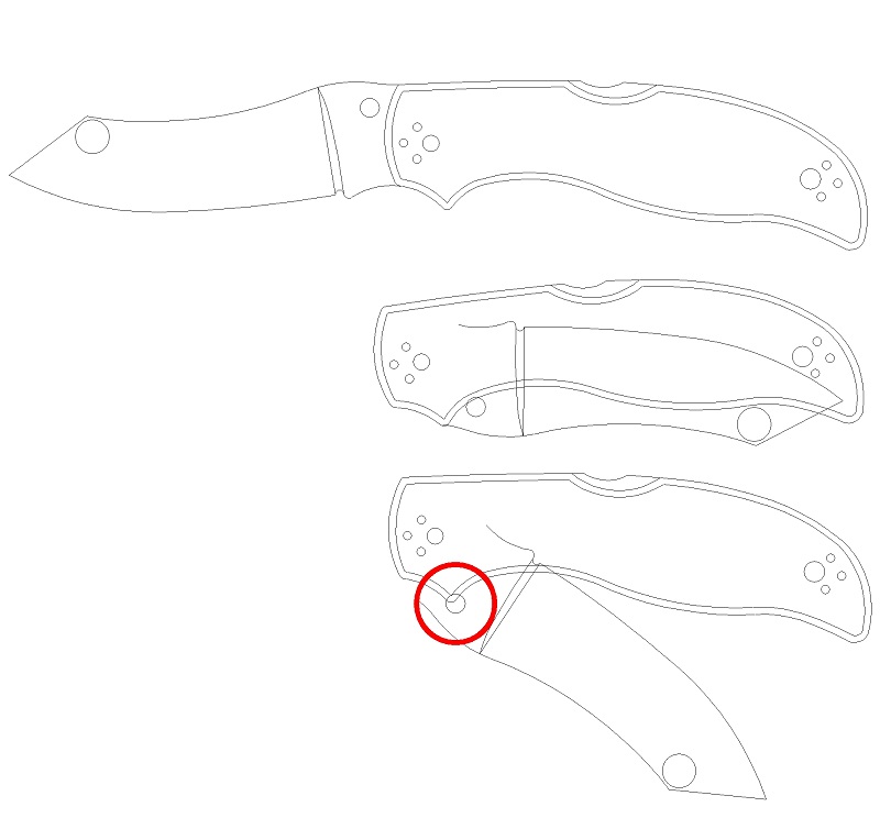

Happy New Year! We wish all of you a healthy, happy and successful 2015.
Thanx much for the thoughts shared. We have created a 2nd drawing ( some designs have gone through 20+ refinements ) that I will send to Peter today. If he has time, perhaps he can post it this weekend.
On the locking closed concept. In my opinion, adding a notch to the tang to keep the knife locked closed is not an impossible task, just some engineering. But a lock-back is very difficult to unlock to open the knife. especially if a strong spring is used. It is not a user friendly manipulation, and I believe it will make the knife too difficult to open, and will reduce the success of the the design. Using a different lock is possible, but if the locki is user friendly and easy to unlock, then it is also easier to flick open.
The next refinement is different in that I eliminated the "Rhino" hump and moved the dent to the trademark hole postion. (and put the hole through the concave dent) I believe it would be possible to open the knife with the thumb and index finger in this position, though not as easily as the "Rhino" hump. This is not to say that I still think the "Rhino" would be more functional, but I feel that all of the possibilities should be explored. I have been using the "Roadie" for weeks as an EDC and the Double Dent at the tip is very user friendly and functional.
I also reduced the belly and raised the rear of the spine as JO3 suggested. I didn't change the handle as the handle is the one planned for the next Stretch model. It is very ergonomic and permits us to uses the same tooling for this model. At least for now, that is my thinking. The change that JO3 suggested for the handle is for "looks" only and would not make a difference in function.
Please let me know your thoughts on the next design and see if you can get more participants from Germany sharing their thoughts. Sometimes the more input the better. Sometimes not; a camel is a horse designed by a team of engineers.
sal

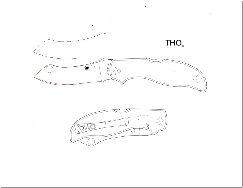

Hello Sal,
I made another sketch, based on the stretch handle. I made the tip a little pointier and the blade a bit beefier, gave it a rounded thumb ramp and a small "ricasso-nick"(or whatever it's called :rolleyes:). Also I moved the Spyderhole more towards the pivot, this way it gets partly blocked by the handle while opening (I marked the spot), which should make it pretty much impossible to use it for one hand opening.
Of course, the pointy part of the spine could be rounded, but I liked it more this way; just my personal preference. Also, "jimping" should be, where it was on the original sketch, but it's still just a sketch and I just couldn't really draw it without spending too much time...
It's still not shaped like a classic Spyderco, I know, but I think doing things different isn't a bad thing.
....wow, I'm getting really invested in this thing ;). I hope the final product will be a huge success for you. Best of luck for you and Spyderco for 2015.
