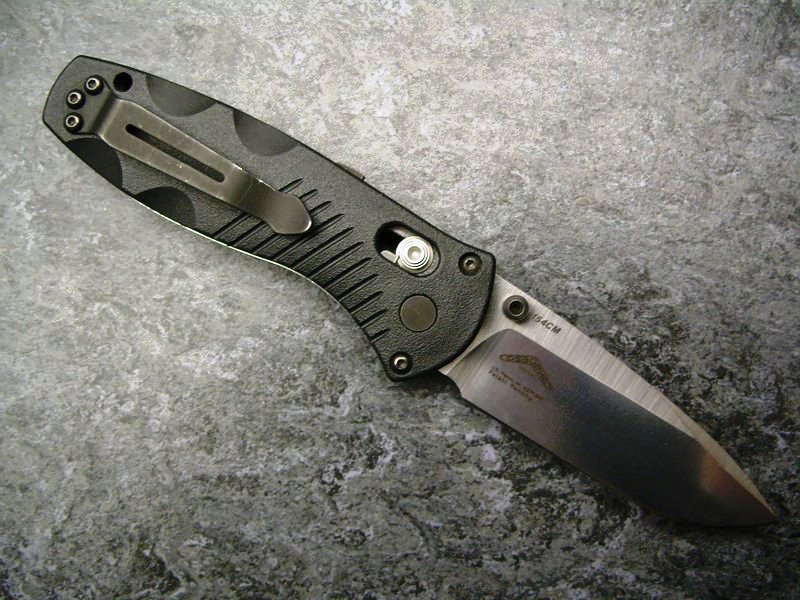

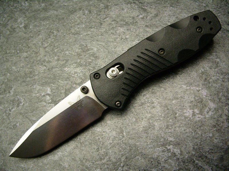

First of all I want to say thank you to Benchmade for supporting this passaround and giving us the chance to test this knife in practical use.
First impression:
The first impression was like :hehe:. I expected a bigger knife, but ok - it's the MINI Barrage. So this was my mistake - I had the wrong prospects. Don't ask me way :). After I took it out of the box I was really happy, that it was not bigger. The size was perfect! . So, it's time to have a closer look ...
Blade:

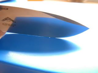

The blade is made of 154C. Definitely one of my favourite steels. Hard enough to use it as an EDC knife, soft enough sharpening it.
The blade was absolutely sharp out of box. Also the blade shape fits very harmonic to the handle. I used the knife for cutting things in the kitchen (tomatoes, meet, pizza, ...), outdoor (tracking) and during work (opening boxes and cutting polymer films). The blade did every thing more than fine.
Lock:
Until know I thought the AXIS lock is the number one regarding locks. Know I have a new favourite - the AXIS-ASSIST lock !! I love it. Easy to open, easy to close, and very safe with the safety button. A small disadvantage - it does not fit to the German law :-(
Handle:
The handle material is not the premium material Benchmade uses, but it is solid. I do not think, that it will break in normal use. So for an EDC knife absolutely adequate. Also the handle shape and the pattern fits good to my hand shape.
Summary:
A very beautiful knife with the potential to become my favourite EDC knife. Not to big, no aggressive look, "social compatible" for the public. Maybe I will exchange the handle material for something more noble - for example CF ;-)
But nevertheless it is not compatible to the German law. I think that the only minus of this knife.

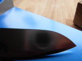

I did some carving, kitchen work and gutted a few cartons and was fully satisfied.

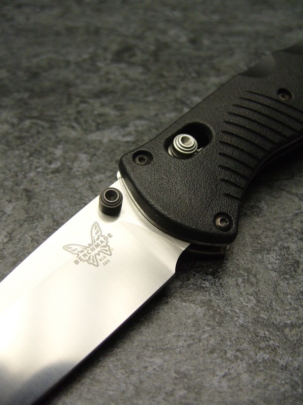

The thumb stud was quite aggressive. After playing with the assisted opening mechanism (it's great, by the way) for a while your thumb may scream „Stop it! At least for a while.“ But this may change due to wear.
The opening mechanism is great and the security lock easy to handle. I usually put it on but do not think the blade would open unexpectedly in your pocket.
Closing the folder one-handedly is not as simple as without the assisted mechanism but after a few tries it worked with ease.

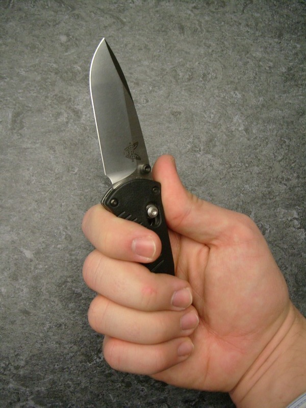

Die Größe des Griffes empfand ich mit Handschuhgröße 8,5 als ausreichend, Leute mit größeren Händen könnten so ihre Probleme kriegen, speziell hinsichtlich gröberen Arbeiten, die ein festes Zupacken erfordern.
Apropos Zupacken: Bei der Arbeit ohne Handschuhe drückt der Clip doch etwas unangenehm, was aber bei der Hauptaufgabe des Messers (Nahrungszubereitung, Späne schnitzen zum Feuermachen, etc.) wohl weniger stören dürfte; für´s Grobe trage ich ohnehin noch ein Beil und evtl. ein größeres Fixed bei mir.
Alles in Allem ist das Mini Barrage ein Messer, das mich vollauf überzeugt, aufgrund der bescheidenen Rechtslage in Deutschland aber nur bedingt zum Einsatz kommen kann, gerade durch das eher technische Design und die Federunterstützung, kam es bei meinen Mitmenschen schnell zu skeptischen Blicken…

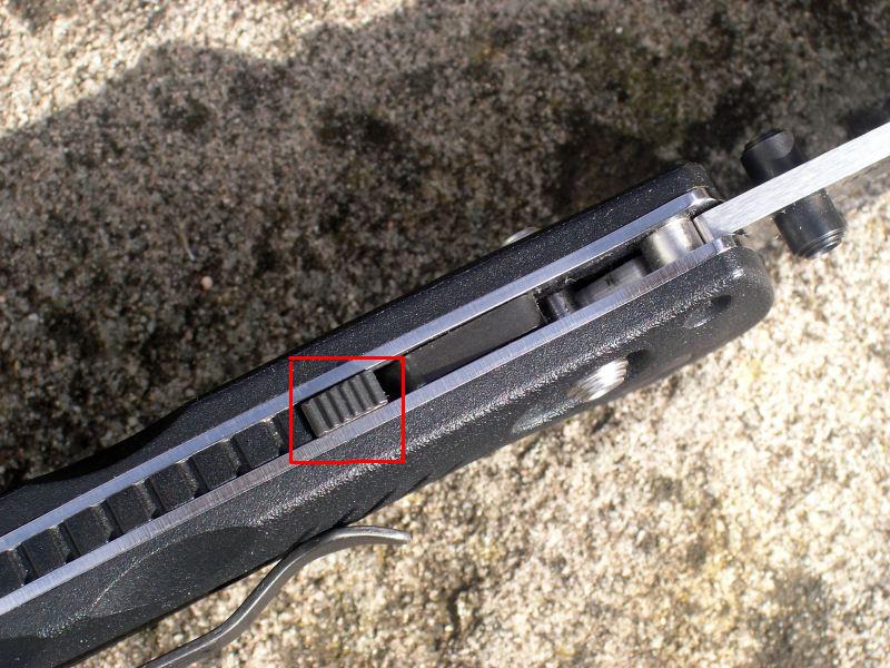

And here is one detail I like. (would be nice to see somthing like this on more BMs) The polished steel inlay is great, too, looks noble (Ok, you can't see it in this picture very good but in real it's a big difference to the 710)
